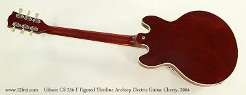

skydog52 Posted September 16, 2022 Share Posted September 16, 2022 Millennium is probably the closest. The Gibson CS-336 is a semi-hollow electric guitar manufactured by Gibson Guitar Corporation's Custom, Art & Historic Division. Introduced in 2001, the CS-336 was the Custom Shop's first "tonally carved" guitar, meaning that the back, center block, and sides are carved from one single piece of wood. Link to comment Share on other sites More sharing options...

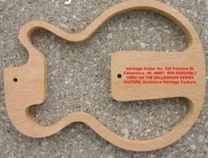

skydog52 Posted September 17, 2022 Share Posted September 17, 2022 Body specs on ES 336 states 13 inches wide by 16 inches long body. Millennium states 13 inches wide by 17 5/8 inches long body. Gibson carves their body out of one piece of mahogany with the top added while Heritage has a slab with the top and back added. 1 Link to comment Share on other sites More sharing options...
Gitfiddler Posted September 17, 2022 Share Posted September 17, 2022 4 hours ago, Steiner said: Isn't the LP Supreme the same? It was similar. The LP Supreme has a carved top/back and similar mahogany sandwich inner core. The CS-356, like the CS-336 also had a carved top, with a hollowed out Mahogany back/sides, the same as the Millennium. However, Heritage offered a few variants of the H-155 and Millennium, the higher end versions (e.g. Millie Eagle) had a LP Supreme-ish carved flame maple back. 2 Link to comment Share on other sites More sharing options...
Steiner Posted September 17, 2022 Share Posted September 17, 2022 10 minutes ago, Gitfiddler said: It was similar. The LP Supreme has a carved top/back and similar mahogany sandwich inner core. The CS-356, like the CS-336 also had a carved top, with a hollowed out Mahogany back/sides, the same as the Millennium. However, Heritage offered a few variants of the H-155 and Millennium, the higher end versions (e.g. Millie Eagle) had a LP Supreme-ish carved flame maple back. Succinct and comprehensive; thank you! 1 Link to comment Share on other sites More sharing options...

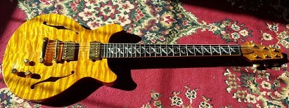

greywolf66 Posted September 29, 2022 Share Posted September 29, 2022 I have the CS-356 which is the upscale version of the 336 . They are a carved top as well . The closest I've found to the 336 other than that is my Jaros Gatlinburg , built by Tony Nagy ( Gruhn's / Gibson) . They are unfortunately rare but worth the look. They don't have the warmth of the ES 339/335 H535 but cut well in the mix. 1 Link to comment Share on other sites More sharing options...
