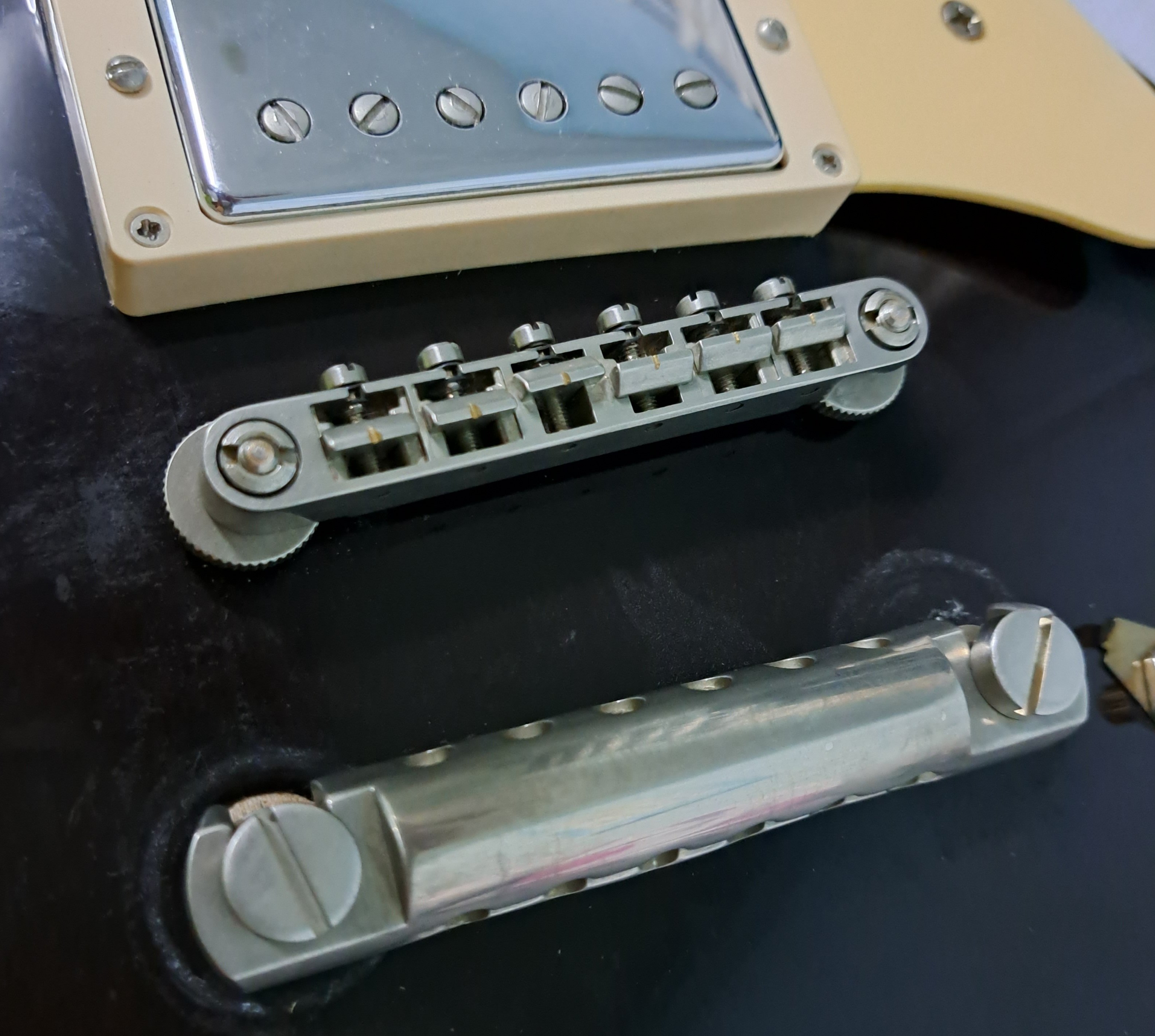

hopkinwfg Posted July 8 Share Posted July 8 Howdy peeps !! Finally gotten the abrn locking bridge set and tailpiece by Faber !! It just look more of an LP accurate ! But one thing is the installation isnt as smooth as what it thought so for me .... after my first installation i found the bridge locking stud on one side being unable to fit in and screw in as the pole piece was too far off centered... tried hammering to sort of bend the post slightly and Ops... the upper threaded portion of the post broken off.... did a tap in screw thread and took off that stucked post well.... Contacted Faber and he was kind enough to send me a set of new stud.... and just gotten it fixed its looking great now..... Larry Corsa is a kind guy to deal with as his business ethics is worth enough mentioning... !! Anyway just after i gotten the Faber ABRN bridge i just caught a crazier boutique bridge call 4 uncles restorations..... does anybody know if they offer ABRN replacement ? The Nashville instead of the ABR-1 ? Link to comment Share on other sites More sharing options...
hopkinwfg Posted July 8 Author Share Posted July 8 Pics .... cant wait to polish up the guitar install the 498T, strung up and hear the glorious tone... ! 1 Link to comment Share on other sites More sharing options...

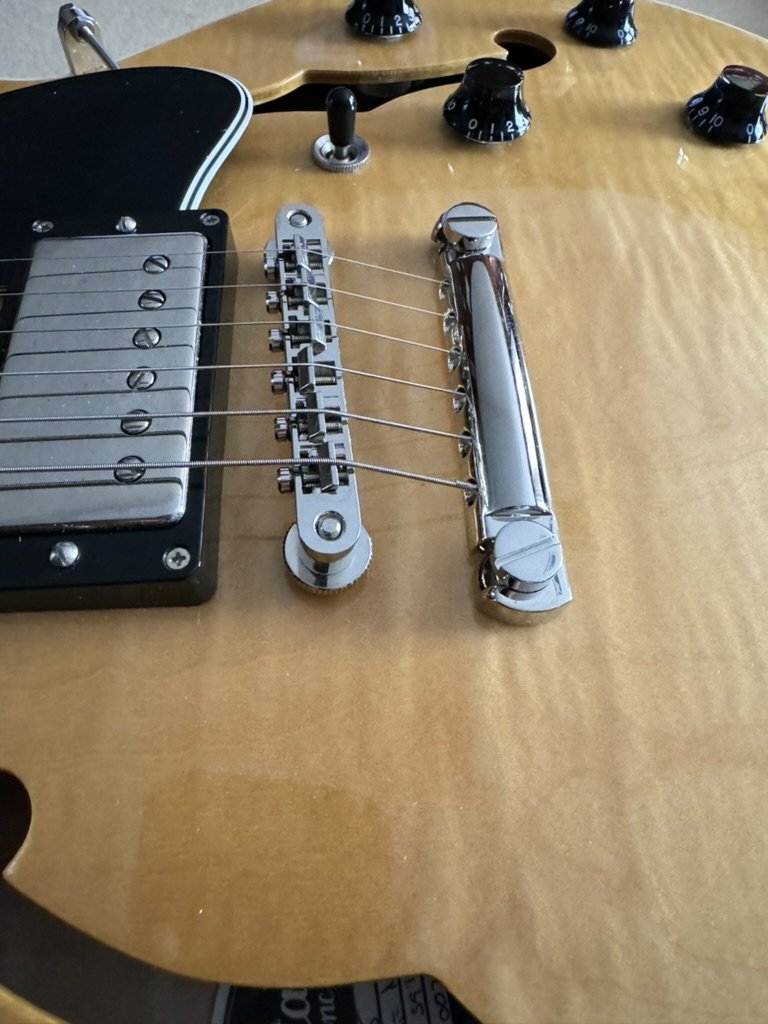

lwilliams Posted July 8 Share Posted July 8 Every Heritage that comes into my aresnal gets the full Faber treatment: Bridge and studs, tailpiece and studs. I do not use the locking parts. The non-locking parts sounds better to ME. . 1 1 Link to comment Share on other sites More sharing options...
