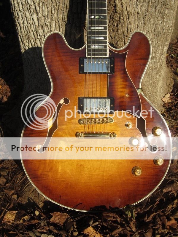

RJLII Posted March 3, 2014 Share Posted March 3, 2014 I refinished my H-550 pickguard using black dye that Pete Moreno gave me. I just sanded off the old finish, dyed the wood, applied several coats of laquer with wet sanding between coats. then hit it with some rubbing compound follwed by paste wax. I scraped the binding the same way they do at the factory. Before: After: Link to comment Share on other sites More sharing options...
tulk1 Posted March 3, 2014 Share Posted March 3, 2014 I refinished my H-550 pickguard using black dye that Pete Moreno gave me. I just sanded off the old finish, dyed the wood, applied several coats of laquer with wet sanding between coats. then hit it with some rubbing compound follwed by paste wax. I scraped the binding the same way they do at the factory. Before: After: What a great job on that .... finger rest ..... Is it the angle or color? But it appears to have more binding as black than it did originally. Link to comment Share on other sites More sharing options...
Redsand Posted March 3, 2014 Author Share Posted March 3, 2014 Bingo.....thanks for input Kenny, your results look fantastic! Link to comment Share on other sites More sharing options...
RJLII Posted March 3, 2014 Share Posted March 3, 2014 What a great job on that .... finger rest ..... Is it the angle or color? But it appears to have more binding as black than it did originally. I think it's just from being out in the sun. The white edge is really glowing. Link to comment Share on other sites More sharing options...

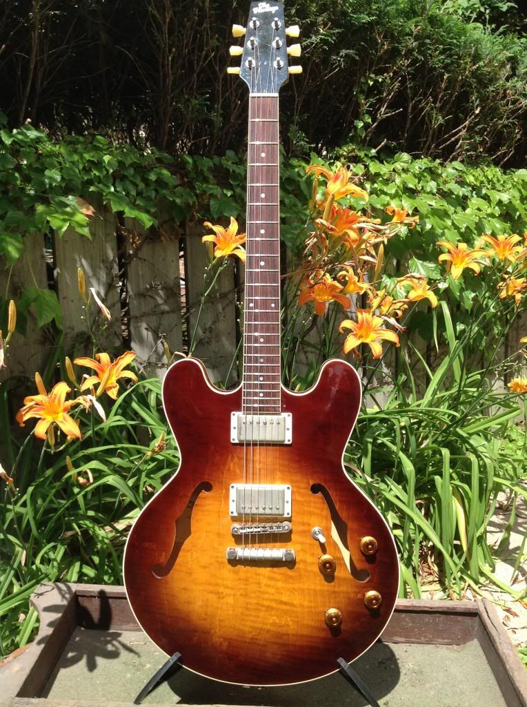

kidsmoke Posted March 3, 2014 Share Posted March 3, 2014 Like you Matt, I've wanted to go black on the PG for my 535, being lazy as all get out...it never occurred to me to refinish it, I just wanted to buy one. The appropriate ones were snagged (er...snatched) from the listing referenced above, I explored grabbing one at the plant last August and it didn't come together...and I like it naked as well, so there is sits. You've got dibs on H's pickguard, but if you really want to do it yourself and pass on his, I'll take it. They do look good nekked, though. with without Link to comment Share on other sites More sharing options...
