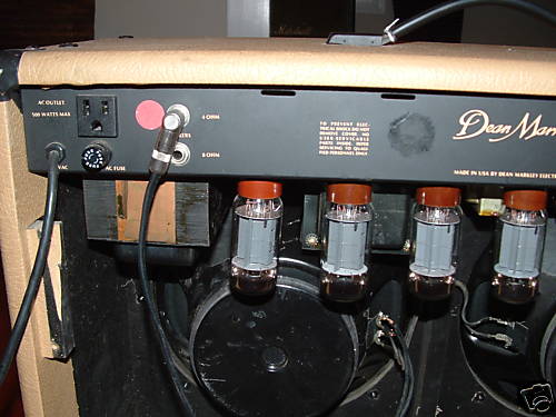

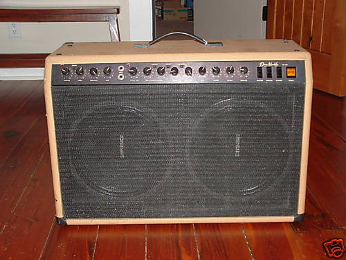

I love these Dean Markley all tube combo's from the early 80's. They run smokin hot and some had transformer problems,so it's good to have a tech go through them. Very versatile and amazing cascading gain. With drive/gain/master control , you can dial in awesome tone. They made some with different solid state sections , but this is all tube heaven. It's shipping on Monday.... ( yeah Mark , you told me I needed more tubes.... ok,ok) CD-212 made in Santa Clara California
It has just been serviced. Re-tube and bias and new speakers. it says that it has... "groove tubes 3-12ax7 preamp tubes and 4 Syveltania 6L6 power tubes" ( I assume thats a misprint on the power tubes )

Smokin' Tone... but I have to learn how to tweak the knobs on this one. I'm not sure if I like the Eminence speakers yet, I did manage some nice tone , but want a little more bottom end . Maybe they need broken in. I will test on a Celestion 4 12 cab later....
Ya know... I'm used to a gain and a master volume to set tone and volume. Or on the smaller Markley amp ..Drive and Gain and Master.
On this one , you have to also turn up the "Clean Vol" , who would have guessed. I am starting to get a handle on the sounds . It also has a half wattage switch which helps.
The sounds keep improving as I learn how to finesse this one. Sustain that won't quit and a nice bark when called for. I sustained a chord for a moment and it developed into a nice growl..... It can sound angry at times, if the gain is up.
It was described as having a Fender-like clean sound , but more musical. And I may agree , the harmonics are rather nice.

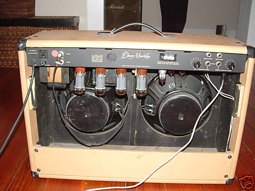

I plugged this combo into a 4-12 celestion cab and ...OMG. unbelievable bite and bark. It doesn't do the modern super high gain sounds, but will do nice high gain rock sounds with lots of harmonics and sustain that will not end. My ears are still ringing and I had it on half wattage and up to 3 or 4. The amp portion passes with flying colors. But ... the speakers in the combo... at least two things I must address. Although the ohms are as they should be, I believe one speaker is making a noise when driven hard . And there is not enough low end: I am largely blaming this on the fact that the back is completely open. So I plan to at least partially seal the back. And I am considering removing the speaker from an old fender cab that I have. to put in it. It is an old EV SRO with the massive white magnet . ( 16 lb. magnet ) For now I will use the 4 12 cab with it while I look at speaker options. I'd like to use a speaker that I already have lying around the house to replace the one if I can . I have several to pick from....

Incredible power in this amp. I found out what my speaker problem was.... the second 12 was wired backwards. I am still getting too much microphonics out of this , not like my smaller one.. I'll have to investigate closer soon, right now I have other new toys to play with....
