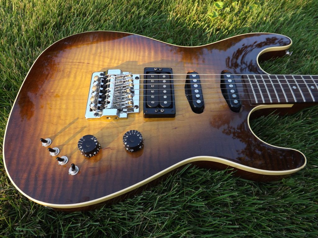

This summer I picked up my beautiful time-capsule 1986 STAT (the year I graduated High School) from our buddy and great player, Rhodescholar. He gave full disclosure before I bought it that the neck and middle pickup were not functioning. A couple of you guys took a look at it at PSP, and couldn't figure out what was wrong. I FINALLY took it to my tech today, and he just called me to tell me the bad news; the neck and middle pickup are dead. They are sealed, and can't be rewound, yada yada. He walked me through the steps he went through to make sure it really WAS the pickups and not the switches/wiring, and I trust him.
My question for you guys is: Should I try to find Schaller Single Coils, or replace them with something different. If so, what would be an equivalent or better to the stock pickups? I'm looking forward to your suggestions!

Let's see some pics of the guitar so we can think of suitable replacements, Schundog :)
You are a Picture-Whore, Howard.... :laughing7: I am all too happy to oblige, however, haha.

I Love My stat! Any excuse to post a picture
