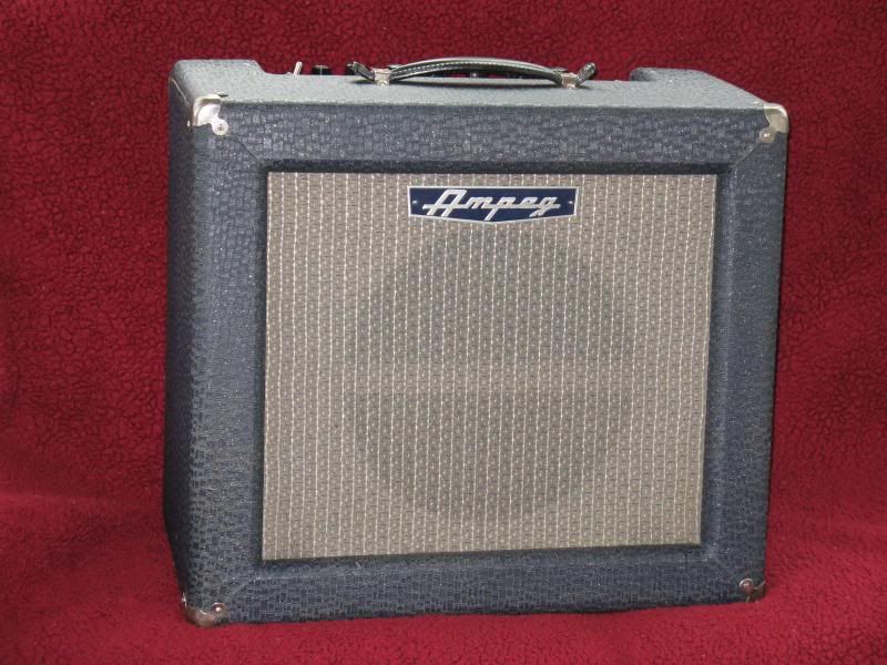

I do a Craigslist search every once in a while to see if anything peaks my interest. I spotted a 1960 Ampeg Mercury in Nashville,Tn. This one is a rare, short lived transition model that uses a 5Y3, two 6V6's and three 12ax7's. Most Ampegs used the octal 6SL7 and 6SN7 in the preamp section until the mid 60's (late 1964). The covering is the earlier "navy random flair" which was used right before the grey checkered covering we all associate with Ampeg. After a bit of "back and forth" with the owner, who was reluctant to ship it, we came to an agreement. After sending the funds, via paypal, the owner discloses that he bought this amp and a few others from Peter Frampton! Nice little tidbit of info that makes this rare amp even more desirable. It should be here by the end of next week. :-)
Looks well cared for. The handle too. That combination with 6v6's, would that be what Ken called the rock & roll ampeg?
I think Ken would have probably given it the "thumbs up" and called it a rock and roll Ampeg. The tube compliment and cabinet size are similar to the tweed Tremolux but the cathode bias factor make it closer electronically to a tweed Deluxe. I've been looking for one of these short lived models for some time as I prefer the 12ax7's over the 6SL7 tube compliment. There's a late 1964 Reverberocket that I would love to find, model R12R-M, that uses one 12au7, three 12ax7's and a pair of 7591A power tubes.

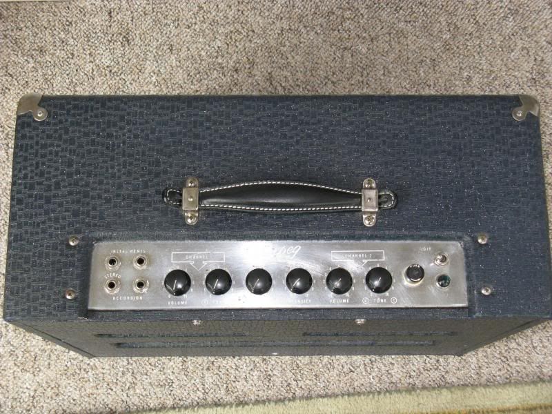

Well, it's here and it's going to need a bit of restoration work. All the coupling caps and most resistors were changed yet the "twistlock" capacitor can is original. Most everything dates to late 1959 except the small magnet/voice coil Jensen P12S, which is dated the 32nd week of 1960 and has been reconed. I installed some Jupiter and Mallory caps and am waiting for a cap can. I also installed a Celestion Blue. The second channel (Accordian) has a "stereo" input and second standard input. The stereo input just bridges the two channels together, which gives the amp a bigger, fatter sound. You do need a mono to stereo cable to achieve this. Oh, and whomever installed the three prong cord didn't attach the chassis ground. Shame on you!

I can already tell that the Mercury has great potential. The tone is almost there. A new twistlock will tighten things up and get rid of some of the "fizzle" I'm hearing. The second channel has what sounds like an open input. This model didn't use shorting jacks. There's hum until you plug the guitar in. I'll go over the grounding and see if a new shorting jack fixes the problem.

A little tone report. The amp sounds real good but , as I do with most early Ampegs, I decided to tweak the negative feedback resistor. I went from the stock 10k ohms to 76k ohms. This changes the "feel" of the amp and gives it some much needed "crunch; at a lower volume setting. I've tried it with blackface Fenders and found I prefer the stock values. The early Ampegs were made to stay as clean as possible for their wattage range. This little mod moves the amp into more of a Fender tweed sound but tighter, more focused and full sounding than a tweed Deluxe. More to come!
