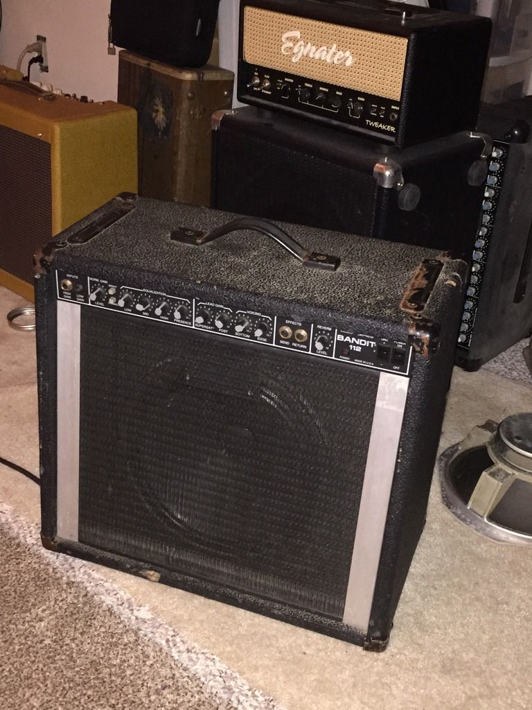

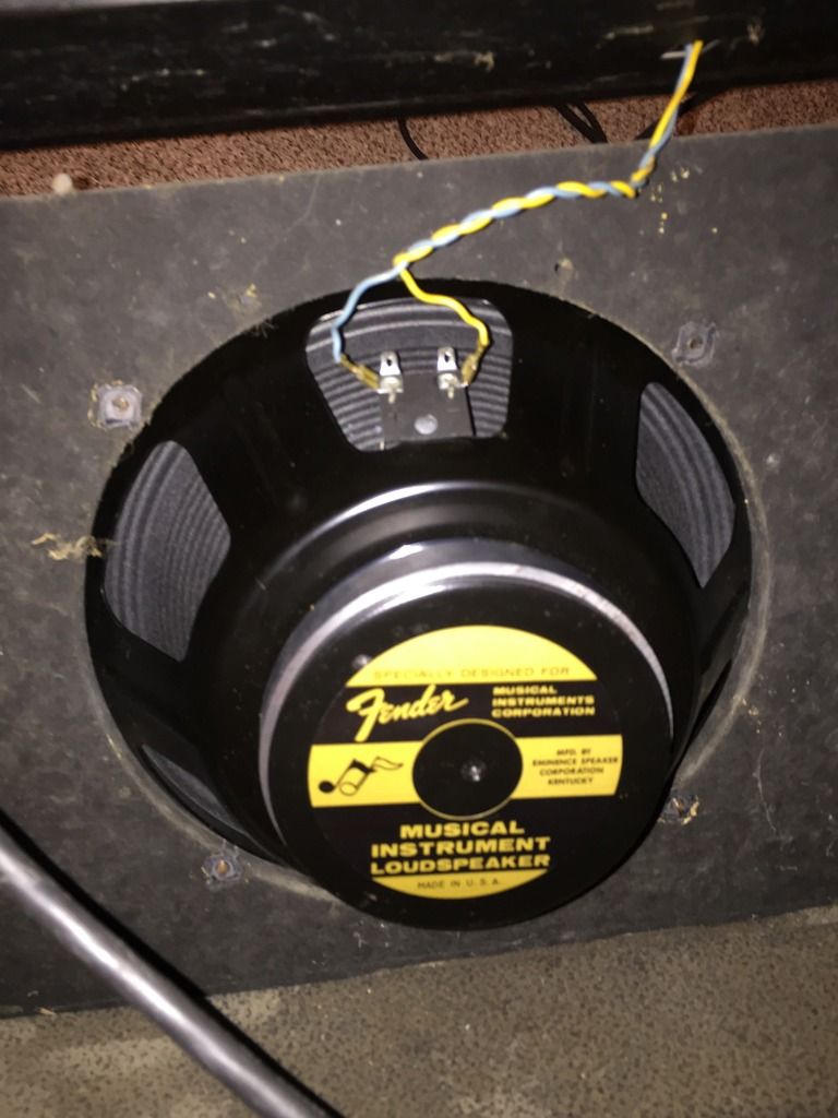

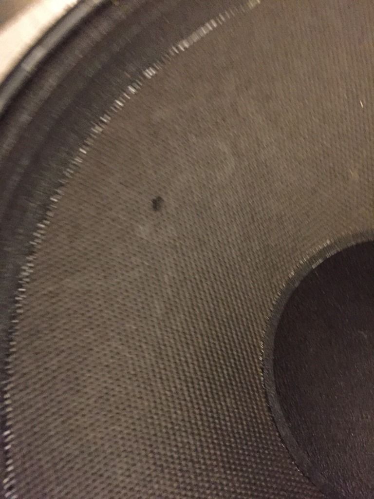

So there is a wannabee Pawn Shop Thrift Store here in town that I stop by at from time to time, and, after using a rode hard/put away wet 90s Peavey Bandit to try out and buy a First Act Volkswagen guitar/gig bag that I quickly flipped for a profit a couple of weeks ago, I decided to go back and make an offer on the old Bandit. They wanted $50, I offered $30, and they took $35. I took it home and found the source of a buzzy sound on some of the low notes; the original speaker had a couple of holes in it. I remembered that I still had the original speaker from my Blues Junior stashed away under the steps to the Man Cave. I retrieved it, installed it, and the thing sounds as good as you could expect. Sure, it's not a Vintage Fender Tweed amp, but, for $35, it was kinda fun to resurrect...

Hard to imagine that little hole in the speaker cone would have much impact.
But if so, it's an easy fix with a bit of clear nail polish.

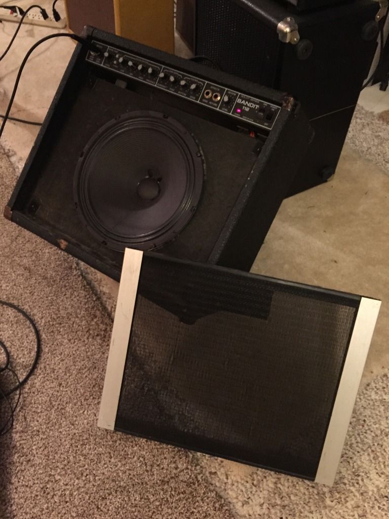

Sheepish update: I played it loud and proud yesterday, and noticed that the buzz WAS still there on the low notes, even with the Blues Junior speaker. THEN, today, I plugged my Line 6 POD HD300 into it, and got even louder. Hmm, what's that smell??? I obviously blew the speaker. I put the old Peavey speaker back in,and still had the buzz on the low notes. I can't think it's the small holes; when I play a low note and touch the edge of the speaker, the buzz goes away. Anything from the A string on up plays clearly. Thoughts?
P.S. I tightened and re-tightened every screw on the thing, and put a small shim of wood between the rock solid baffle and the original speaker, where I heard the buzz. No better....
Maybe a rattle.
Don't feel bad, I had a similar issue with my old Twin from the 70s, had the orange back JBLs, I too assumed it was a speaker blown, they were, after all 40+ years old. I bought new Eminence speaker (dooohh). Made no difference. Ripped into it determined to do my first black face mode..many parts, lots of reading, etc etc. Got er done...still not right.

i FIXED a problem like that once by going to home depot and buying a few window strips used to mount an air conditioner in a window. dense sponge about 1/4 inch thick. I took the chassis out, put some of that window strips along the top and tightened it down. Problem fixed. Wished I hadn't parted with a few other amps I had where I suspect the chassis was causing the rattle. Good luck troubleshooting that
