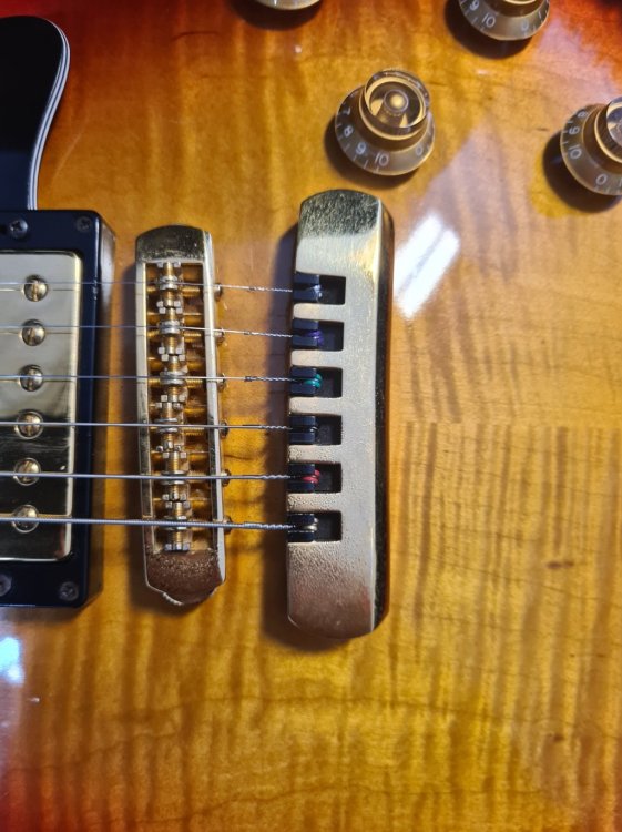

Bluediver Posted June 11, 2025 Posted June 11, 2025 Hi. I am thinking about replacing the bridge and tailpiece on my H157. Does anyone know which make these are and where can I get replacements? (UK based if that matters)
TalismanRich Posted June 11, 2025 Posted June 11, 2025 That version of the tailpiece and bridge was made by Schaller of Germany. They still sell the roller bridge, but I don't think the tailpiece is a current item. Thomann is a Schaller dealer. https://schaller.info/en/bridges/ If you want to change the style to a more common bridge and tailpiece, many people here swear by the Faber units. The trick it to make sure that you use the correct spacing.

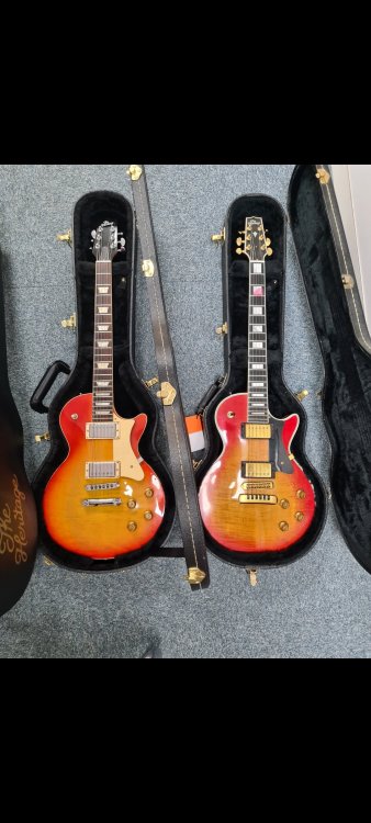

bolero Posted June 13, 2025 Posted June 13, 2025 That is a nice looking top! How about a pic of the whole guitar?
Bluediver Posted June 13, 2025 Author Posted June 13, 2025 14 hours ago, bolero said: That is a nice looking top! How about a pic of the whole guitar? Here you are... with it's H150 brother
DetroitBlues Posted June 16, 2025 Posted June 16, 2025 Hardest thing is about swapping is the inserts. I cannot remember, but I think the bridge is metric and the tailpiece is imperial. Its been a long time since I swapped the original bridge/tailpiece out on those old schallers.
bobmeyrick Posted June 16, 2025 Posted June 16, 2025 I've changed a few Schaller bridges/tailpieces and I can confirm that both the Schaller and Nashville bridge posts are 5mm thread, so you don't need to change the inserts if you're replacing the Schaller bridge with a Nashville bridge. Same with the tailpiece studs, thought the thread is 5/16" rather than metric. On my H150 VSB I'd replaced the Schaller with a Nashville setup, and decided to replace the Nashville with the Faber ABR-1 conversion. This involved using a 5mm bolt to gently extract the bushings. I needed to make the hole slightly deeper, but aside from that the process was pretty straightforward. Some photos of the procedure...
