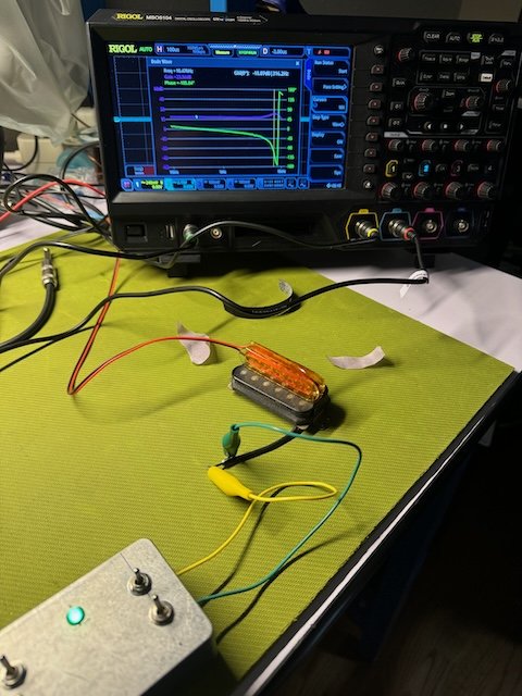

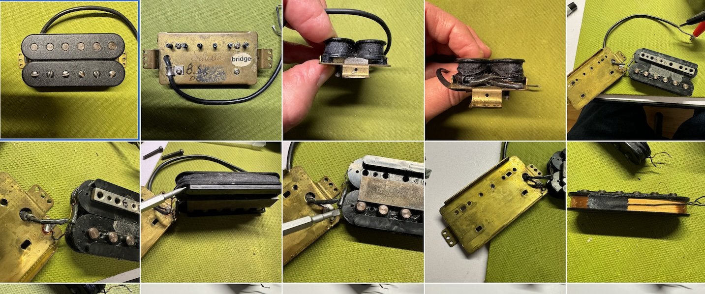

Yes, I have. A bunch of them actually.
Schaller made pickups from the same stuff everyone else does.  Here's one fully apart. Alnico V magnet, 42AWG copper wire, 8.5k DCR, I have the electrical and magnetic measurements as well, Inductance, Ls 4.98 henries, Q2.02, Cs 98pf, DCR 8.394k.
Also the same pickup being characterized on my oscilloscope with an exciter coil connected to a signal generator.
Personally, I liked the Schallers better. You be the judge.

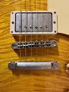

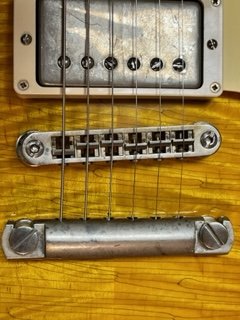

The aluminum Pinnacle bridge and stoptail on the 150 Custom Core is definitely a step in the right direction, but I wish (for at least the CC models) they would have used a locking Faber ABR or an original ABR-1 bridge.  The biggest problem with the Pinnacle bridge is it uses proprietary bridge studs (screwed directly into the top) that are larger in diameter than the original ABR-1.  The Faber locking ABR bridge will still work if you use the Pinnacle bridge studs, the Pinnacle thumb wheels, and the Pinnacle locking top screws.  I am not sure if a traditional (non-locking) ABR-1 will fit with the large Pinnacle studs.
Original hardware...
Locking Faber bridge (using Pinnacle bridge studs, thumb wheels, and top locking caps.  Locking Faber stoptail studs using the Pinnacle aluminum bridge.  Stoptail is flat to the body.
