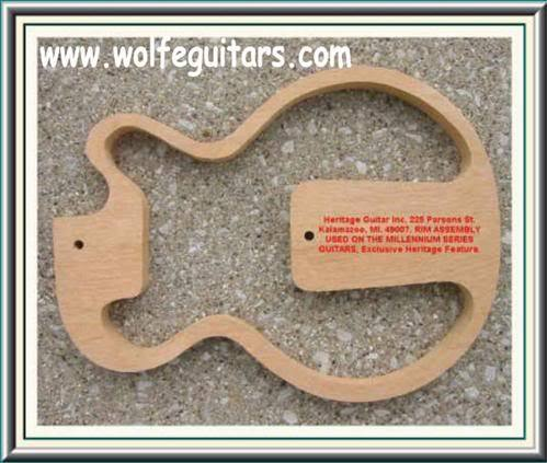

The Millenium's construction is closer to a CS336/356, with a Mahogany center core.  (see image below).
Millies are Semi-Solid.  535's are Semi-Hollow.  Its tone is closer to a solid body than other semi hollow body gits.
