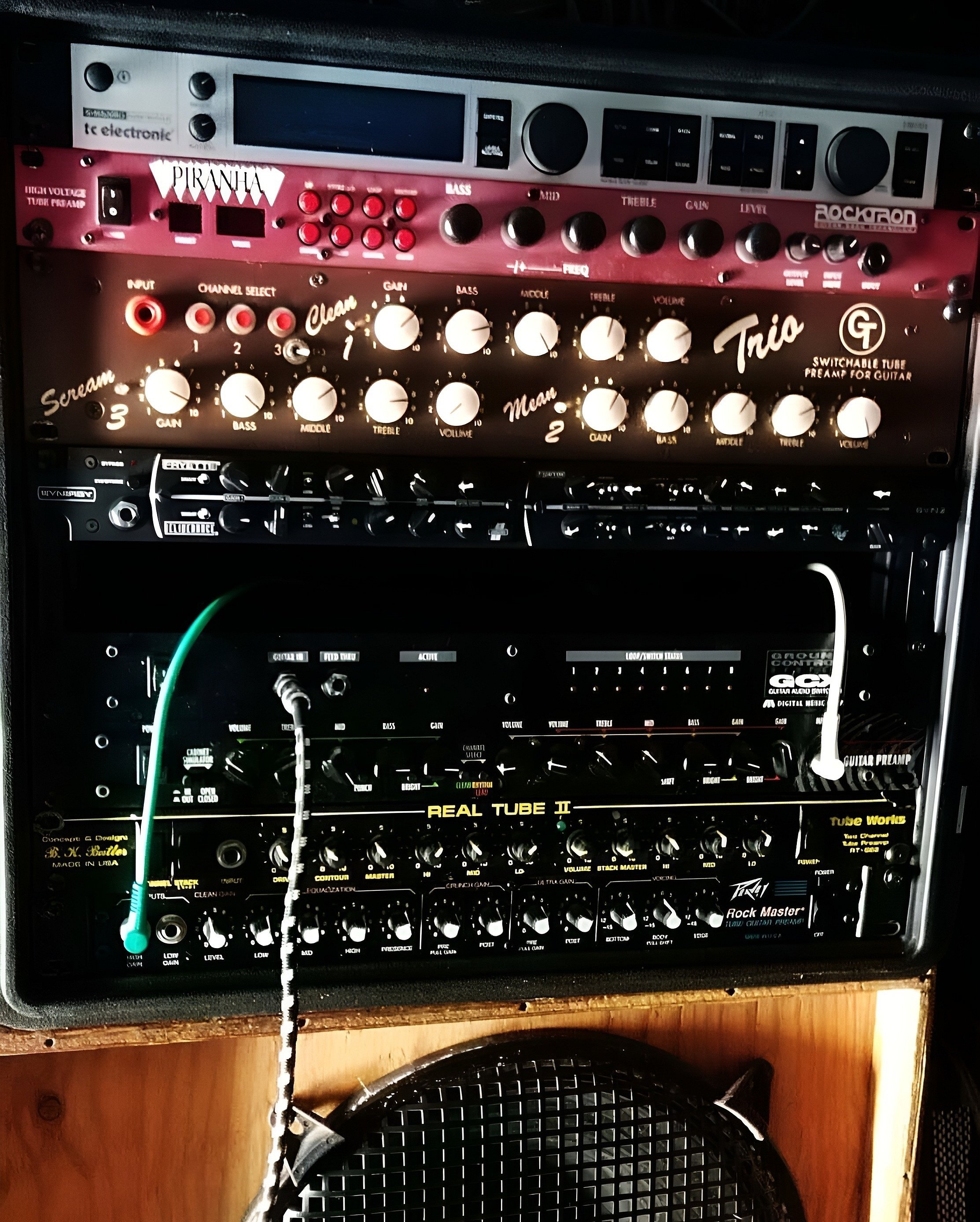

mars_hall Posted September 30 Posted September 30 When I ask this, I do not mean who sends MIDI commands that are decoded by the amp at the end of the path, but rather are decoded by a device that converts the command to discrete TRS or TR signal levels that are plugged into the amp's 1/4" footswitch jacks. I know Voodoo Lab makes the Control Switcher for this function, but was hoping to find a less expensive alternative. Disaster Area Design makes a solution more geared to signaling pedals via smaller TRS cables that are not footswitch output jacks but rather replacements for the much larger 5 pin DIN connector. In other words, the same MIDI command is transmitted through a smaller physical interconnect yet it is still undecoded from a footswitch input point. I would be OK with a solution that did the decode and put the signal levels out on a 5 pin DIN connector, as this is what my Groove Tube Trio preamp can accept as an alternatie to the the normal 1/4" jacks. See the 5 pin DIN foot switch connector below. What I am working on... The intellifex processors are gone with a TC Electroni G-Major/2 in their place. What do you know and/or use? Thanks in advance

bolero Posted October 2 Posted October 2 So you want to control everything in that rack with a MIDI controller? and the GT amp has no MIDI input? try a MIDI to CV converter & hook it up between your controller & the GT amp I'm assuming you want to save configurations on your main controller, then have it send commands to multiple rack units via MIDI
mars_hall Posted October 2 Author Posted October 2 56 minutes ago, bolero said: So you want to control everything in that rack with a MIDI controller? and the GT amp has no MIDI input? try a MIDI to CV converter & hook it up between your controller & the GT amp I'm assuming you want to save configurations on your main controller, then have it send commands to multiple rack units via MIDI Have to look into this with concerns being cost of the convertor itself and an adaption to latch a TRS plug. The Voodoo Lab Control switcher is about $180 and would do the job but this would be something like a $180 dollar single amp footswitch and that sounds a bit much to switch a single amp when I already have the non-MIDI footswitch to begin with. Thanks for giving me something that might work.

mars_hall Posted October 6 Author Posted October 6 On a related note, I feel pretty happy I was able to get another rack setup going and share resources between them. I used my Hughes & Kettner Access preamp (H&K's response to the Triaxis), which has great tone and feel. I placed this into the effects loop of my Rocktron Prophesy allowing me to use the effects of the Prophesy, which are deeply configurable and sound great. I used the built in responses to drive the front end of the Access (compression, wah, hush,...) and the output effects of the prophesy, very conparable to an Intellifex on steroids.. At the same time I disabled the Prophesy's presamp. I knew this was possible years ago, but finally got around to figuring out the workable paths. Both preamps can be switched in/out via MIDI so it is like an XOR situation. Output goes into my Legacy III which drives a matching 4x12 cabinet with Greenbacks.
mars_hall Posted October 7 Author Posted October 7 Looks like I will go with a Suhr microMIDI to do the conversion for a single amp two channel TRS switch. Reverb has sold used ones in the $70-80 range and new are about $120 shipped
